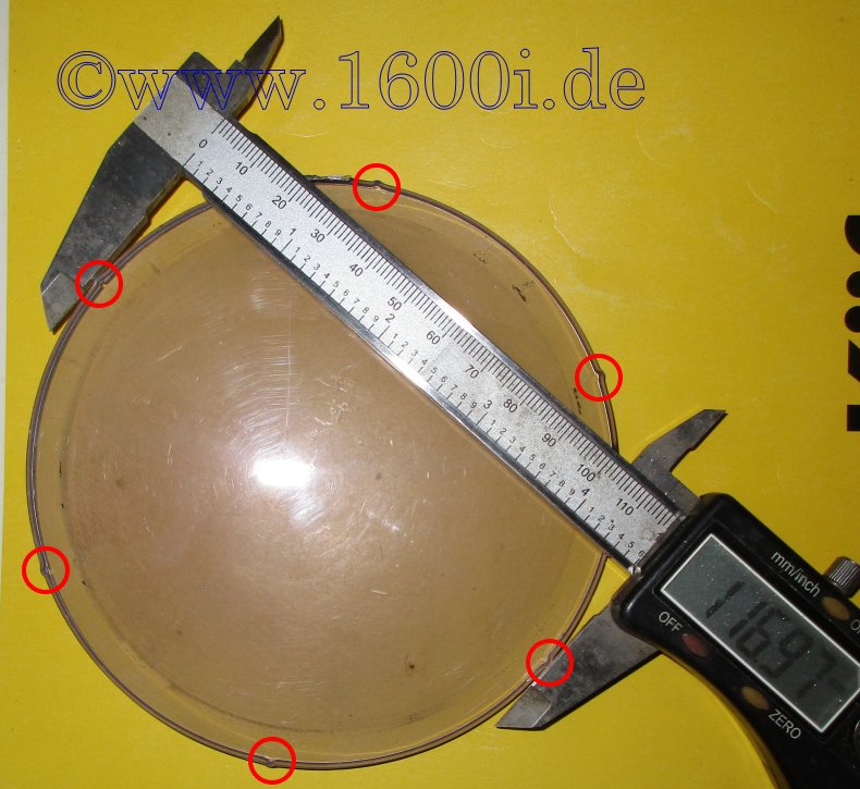

Does anyone know the exact size of the speedometer glass for a Mexican 1600i?

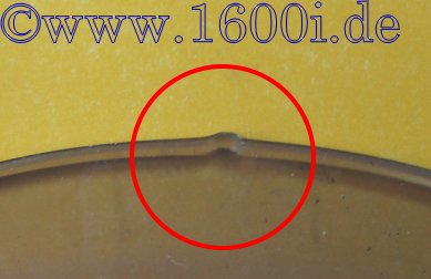

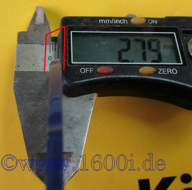

Hello Paul,
is this exact enough ?
117 mm
0,2 - 0,3 mm
2,8 mm
