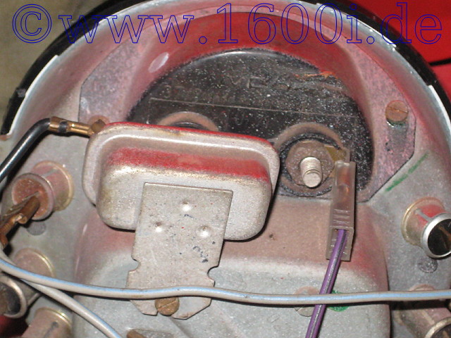

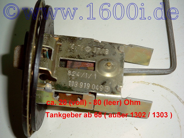

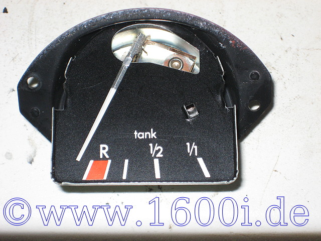

if you use an old spedometer you have two ways to realize the fuel gauge.
- Either use the existing fuel gauge in your old speedometer. If you do that, you have also to exchange your fuel sensor with the old one.
- Replace the old fuel gauge with the one from your 1600i speedometer, this won't fit perfect, but i got some mails from people which had it done.
Pictures:
old fuel gauge
http://www.1600i.de/1600i-elektronik/tankgeber/tankanzeige-alt.jpg
voltage stabilizier (the grey small box in the center of the pic)
for use with old fuel gauge and old fuel sensor
http://www.1600i.de/1600i-elektronik/tankgeber/tankanzeige-alt-konstanter.jpg
old fuel sensor
http://www.1600i.de/1600i-elektronik/tankgeber/tankgeber-alt.jpg

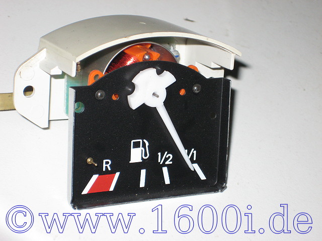

1600i fuel gauge
http://www.1600i.de/1600i-elektronik/tankgeber/tankanzeige-neu.jpg

Attention: You can't change only some parts from old to new or vice versa, they are not compatible !
