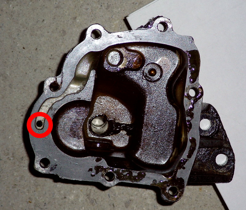

Hello Paul,
maybe not the seal is the problem.
You migth get this also if you have to much oil in the box or the the small hole for the preassure compensation is closed for whatever reason ....

Thank you for this. Do you know if this hole can be accessed unblocked/cleaned without removing the gearbox?

I never tried this, but you should get a view on it above the selector shift from front to rear. I don't think with your eyes, your head meigth be a bit to big, but wih a mirror our a smartpone our camera.
I just saw that there could be a seal in it (scroll the pic.). I don't had one when i replaced the gearshift housing years ago.

Beitragvon Red1600i » Di 16. Aug 2016, 07:58
The small hole is for venting the gear box. Overpressure...
You can mount a small hose made of copper, stainless steel or plastic or rubber... and so the opening is higher and not leaking oil when the gearbox is parked on a hill.

The oil is leaking from the rear oil seal between the engine and the gearbox. It is not engine oil - definitely gearbox oil and the seal has been replaced twice.
Manfred thinks that pressure might be trapped in the case because the hole at the front is blocked so tonight I will try to clear the hole with a compressor.

I think it would be better to open the oil-inlet-screw of the gearbox before using the compressor, so the air could diassapear.
