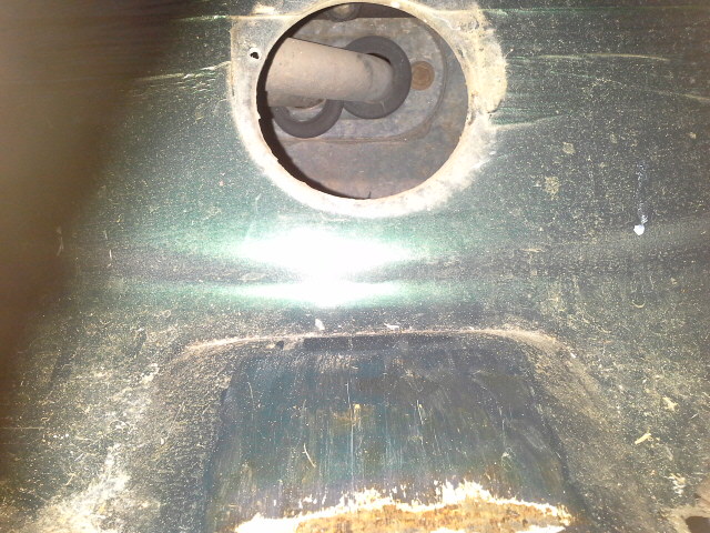

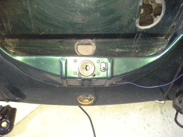

I read I have to remove 2 access place in front of the car and I did but the only thing I see through there are 2 hoses, anything else. The access covers are the one in the front apron and behind the spare tire. Have no idea what those hoses are for.

Accsess holes.
Hoses through access holes.

Maybe the hoses for an Oilcooler. You have to remove the oval tin cover to get out the shift rod.

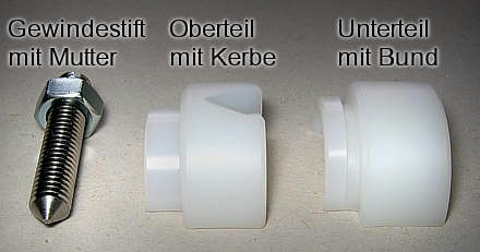

there is a much easier way to replace it.
Use a a split one.
In this case you hadn't to remove the shift rod.
For more details please send me an email

The plate you have to remove is the oval plate between the two beams of the frontaxle. So you have to watch under the car not under the front hood. Then you have to slide the shift axle out and change the bushing
But to use the easier way manfred wrote about would be even better. I'll do that next time too.
