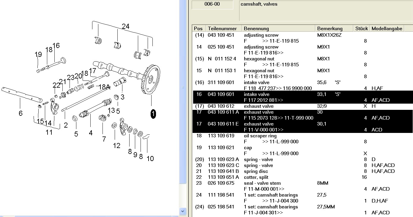

Hello; I need stock heads valve size information for vw bug mexican 1600i.

Beitragvon pablovent » Sa 8. Aug 2015, 13:44
Manfred hat geschrieben:
perfect, why (16) and (17) are larger?
