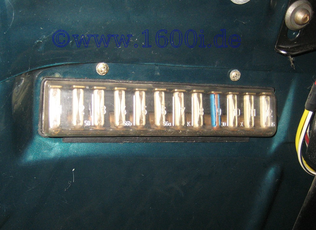

Hello all,
I recently took my car out of storage and noticed that someone has been in the car and had stolen my radio,fuses and some more stuff.
Now i need to reinstall the fuses but i do not know in which order they have to go in! :(
Can someone point me to the richt schematic's or show me a image of how they should go in?
Any help would be much appreciated!!
Its a VW mexico Kever from 1996.
