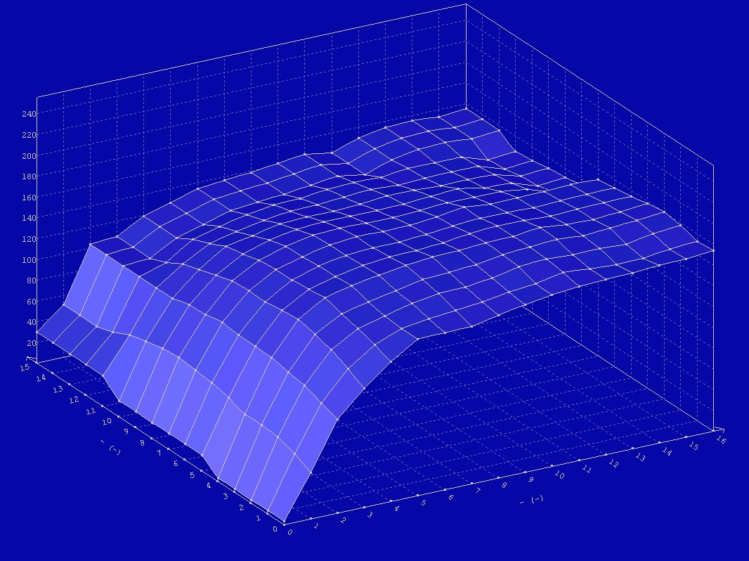

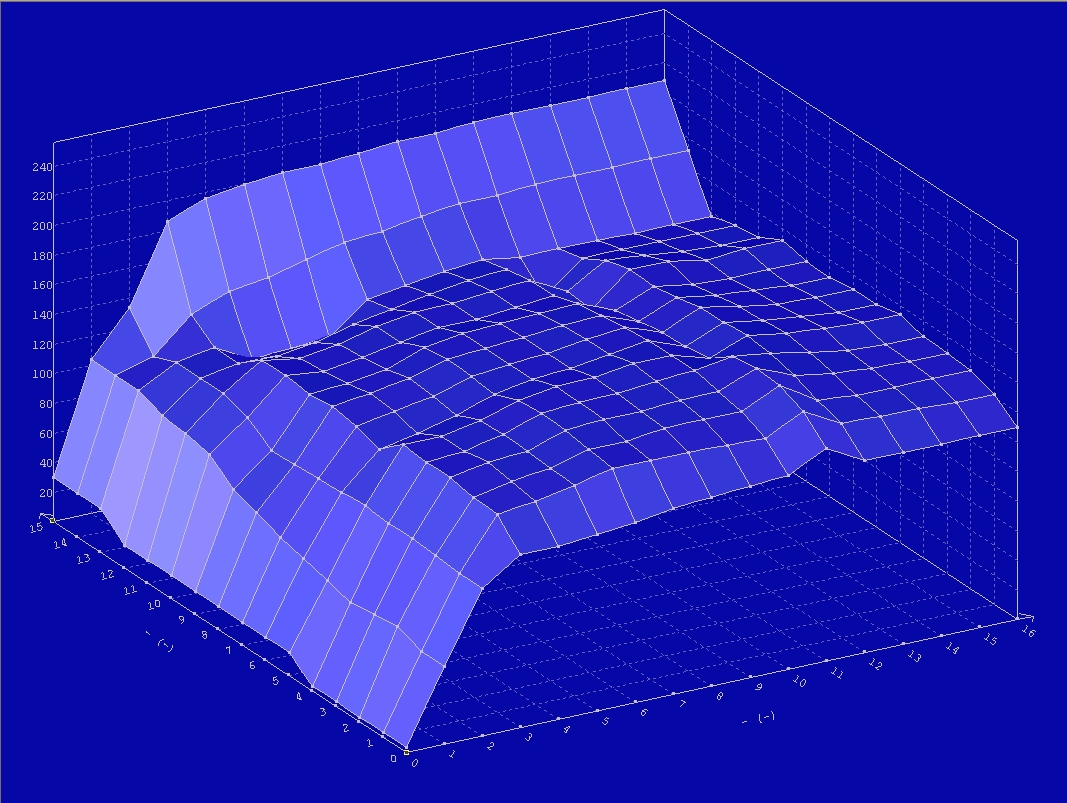

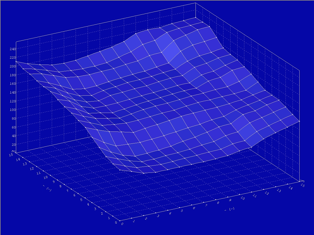

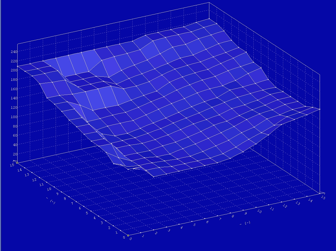

For ex. i show you some maps
First the org. 1600i injection map:
Second the injection map of a 1,8l Mexican Golf ECU
Third the ingniton map of the 1600i
And at least the ignition map of the Mex. Golf ECU
You see the differences ?
Even if it would work on an 1600i engine, you never would be satisfied.
