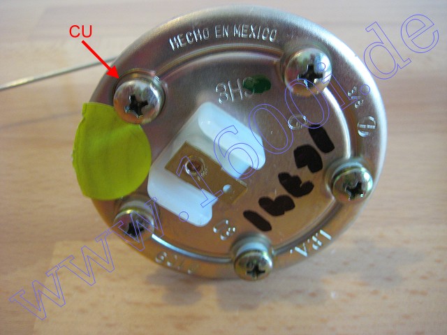

The sensor measures against ground.
Therefore one of the five gromets is of copper.
But that will not help much, if the fuel-tank himself has no good ground conection.
So its allways a good idea to use a seperat ground conection.
