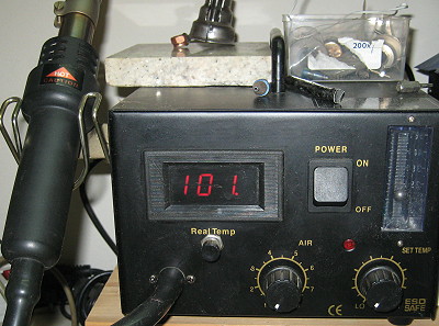

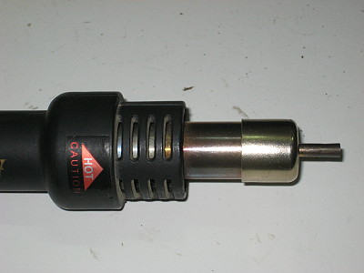

Next i use my hot air gun, normaly used for smd unsoldering, switch it to lowest temperature and air preassure, heat the epoxy until it gets fluid and blow it with the air stream over the surface and into the gap between the alu chasis and the plastic.

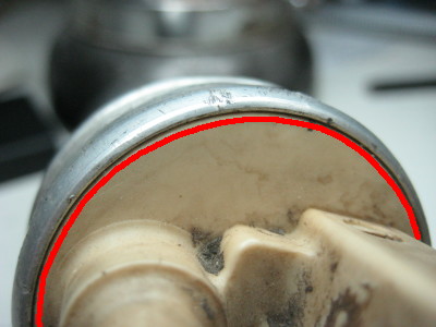

After its hardened it will look like this and will be leak-proof for years. I did this 8 years ago at the org. fuel pump of the 1600i engine in my old convertible. Its still ok.

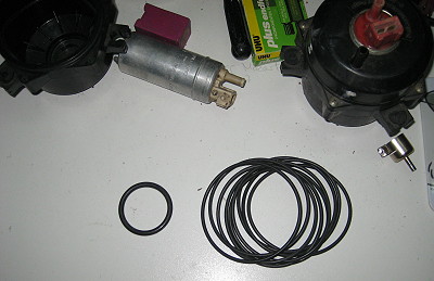

Years ago i bougth some o-rings. At the moment i only found the larger one. Somewhere should be the same amount of the smaller ones.........
I never tested them. But if you like to it. Shippment to Italy will be 1,50 €. You can spent me a beer when we will meet us sometimes. In this case please mail me the adress.

I unscrew the cover screws , lift the cover and…….. surprise! the big O-ring appears damaged
the small O-ring is perfect
I now have samples of the O-Rings , I will try in the local shops for the new parts and then give you the news .
