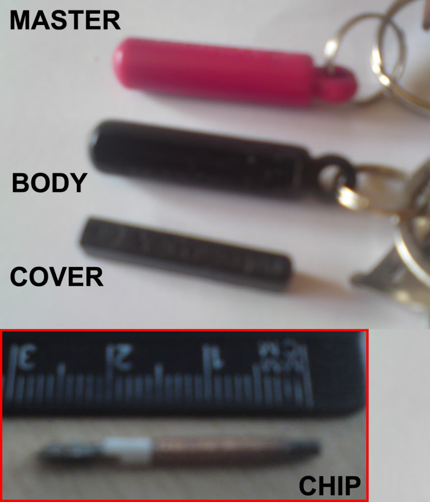

I have a 2003 Mexican Beetle with the Ultima-type immobiliser system. I have two RFID key-fobs (one red, one black) which disable the immobiliser when I pass either fob beneath the ignition barrel.
My black fob has suddenly stop working. My red fob works fine. Until today I have had no problems disabling the immobiliser.
When I bought my car, I only had one working key-fob (red). I purchased a black key-fob from Antonio in Mexico. I have contacted him again to buy a new key-fob but he tells me that VW Mexico no longer supply this part (1BM 937 109).
I have contact an immobiliser specialist and they say: The Megamos id 48 transponder will work in the 1998-2004 beetle (MEXIBUG: I suspect this is the new-shaped Beetle). Vw did use another chip in older models called the Megamos id 13 (T5).
Does anyone have more details on the RFID? Can anyone supply a replacement?
Thanks in advance, Mexibug

At the moment bypassing the immobilizer is a secondary option. Without disclosing finer details, how difficult is it to bypass? The reason I ask is that I am currently limited to a single (Master/red) transponder and my concern is what happens if this is lost/damaged. Do I need this in order to bypass or do I always have a 'Plan B'?

In England, I can buy a number of different replacement VW transponder chips for less than £20. This may be a better solution for me as i could afford to buy more than one. The main problem is identifying which chip is used for this car!!
