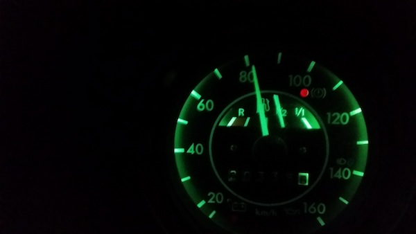

Beitragvon vdubjim » Sa 13. Sep 2014, 18:51
When i drive the check engine light is on slightly.

Beitragvon LoudHoward » Sa 13. Sep 2014, 19:56
Low Brake fluid?

Beitragvon vdubjim » Sa 13. Sep 2014, 23:14
No.
Today i noticed no glow.
The last few times the car ran poorly, or had the light glowing, it was raining! Now to figure out why. :roll:

Beitragvon LoudHoward » So 14. Sep 2014, 08:55
But this is not an check engine light, there is an brake symbol next to it. I think if you check the regularly, like spark plugs, fuel pressure and ignition module you have to read the trouble codes.

Beitragvon vdubjim » So 14. Sep 2014, 17:36
Brake warning? Odd.
Looks like this to me (!)
is there a check engine light?

Beitragvon vdubjim » So 14. Sep 2014, 23:56
sorry for the dumb questions, owned the car a week now.
also your link is to a generic car site. Since there are 2 brake light switch like a late model 70s bug, how can it detect low fluid as referenced?

Beitragvon vdubjim » So 23. Nov 2014, 21:37
FINALLY found something on another site.....
Alternator light and (!) LED flickering:
Alternator brushes worn down. The edges of the alternator brushes can be very gently filed down and re-used. You can get brand new alternator brushes from the VW Classic Parts Center http://www.vw-classicparts.de/ part number 0409035031 at €29.13 + delivery + 19% german sales tax.

Beitragvon phade » Do 1. Jan 2015, 00:20
Ah, you've found one of my old posts (I think I posted it on VZi if I remember rightly). :)
Also check the diode plate at the back of the alternator to make sure that none of the wires on it are loose and make sure that none of the diodes have been burnt out. However, having said that, it may be easier to replace the alternator as the rear alternator cover is very difficult/impossible to remove.
Another item to check is the battery to starter motor cable (especially at the starter motor end) as a corroded starter motor ring terminal can cause the same symptoms (alternator charge warning light on, (!) LED on). I got caught out early last year when the starter motor's ring terminal snapped off due to corrosion.

Beitragvon vdubjim » Do 1. Jan 2015, 04:25
Yes, I think that is where I saw it.
I need to try those things.
I swapped #30 relay, my idle is still odd at times, but it doesn't die.
