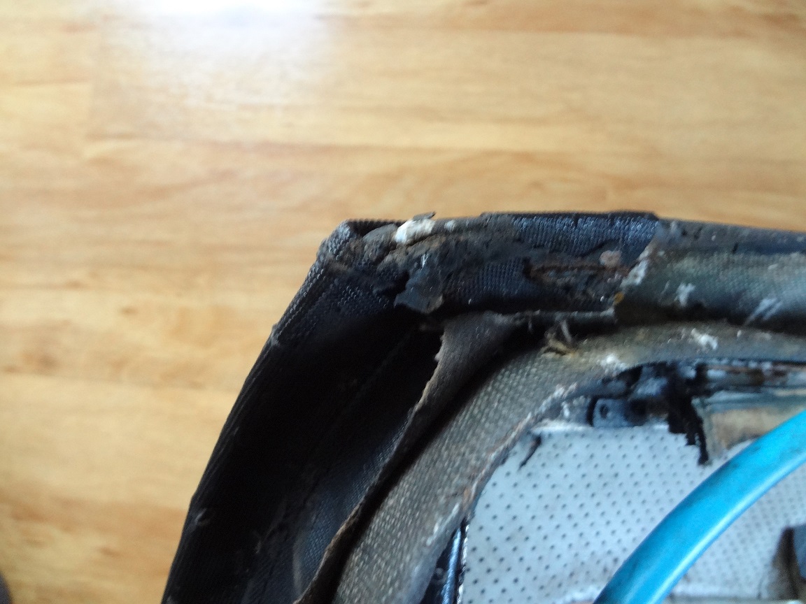

you have two kind of glue:
-the first one is between the composite part (black) and the body, it is the same glue (black) for the window:
-the second one is between the composite part and the soft top in the rear area, it is neoprene glue.
I took a picture before remove the old fabric in the corner
regards
Olivier
